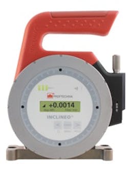

Ludeca Inc. introduces Inclineo, a powerful level/plumbness measurement system utilizing high precision electronic inclinometer technology with a resolution of 0.0003 degrees. In combination with interchangeable mounting bases, Inclineo measures relative or absolute angularity, flatness, levelness, or parallelism of surfaces; as well as plumbness of vertical shafts, perpendicularity of planes, and straightness along a line. Inclineo measures inclination at different positions along a surface enabling exact profile computation of all machined surfaces or flanges. Its versatility makes it possible to check geometry of CNC machines, as well as measuring the plumbness of hydro turbines.
Its 360° rotatable housing allows the Inclineo to take measurements at any angular position, including surfaces with a steep inclination. The system features integrated wireless communication technology that transmits the measurements to a PC to quickly and easily generate measurement reports. The surface profile of the measured component is shown in full color 2-D and 3-D graphic display with color coded tolerance levels giving a clear representation of the results.
